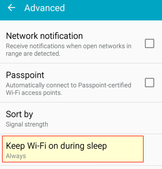

Wi-Fi Setup
Some Android devices may drop their Wi-Fi connection when the device sleeps. While this option may improve battery life, it will cause the Software Remote to reestablish it's connection to the HouseBot server every time the device is taken out of sleep mode. This will delay any possible interactions with the Software Remote for a few seconds while it reconnects.
To avoid having to wait for the reconnection, many Android devices have a setting that will allow the Wi-Fi connection to remain active while the device is sleeping. This option is usually found in the Wi-Fi settings. There may be a menu within the main Wi-Fi settings with an 'Advanced' option that will allow the 'Keep Wi-Fi on during sleep' to be set to 'Always'.
