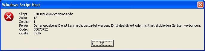

I'm just trying to understad housebot and - coming from the sonos forums - really want to make the sonos integration work. Seems to be great. But it doesn't work: When I run the UniqueDeviceNames.vbs script I get the following error from windows scripting host:

esc:
Please ensure that antivirus software is not preventing the script from running and that you have firewall permissions set to allow network access.

Hi Osler,Osler wrote:esc:
thanks for youf fast reply - I deactivated the FW, stopped AV, made sure the wsc's are properly registered... Then I killed nearly every process I could think of - no effort.
What's odd: I tried to install on the notebook too where first it gave me the same error, but a second attempt worked flawlessly.
The System is XP SP3, full admin rights.

Are you able to run any scripts on the machine? Try a simple script. Cut and paste the attached into notepad then save as Test.vbs and execute it:
Also, have you had any issues with Windows Updater?

scripting is activated...

Hmm... well I am not sure. Is the Microsoft upnp.dll installed and registered on your machine? This is what the .wsc uses to communicate with the ZonePlayer. It should be included with XP, but you never know.
Edit: Please see attached. The .wsc and .vbs files attached will throw some additional message boxes when run to help try to track down precisely where the error is occurring. Also, the required .dll is included. Place it in C:\WINDOWS\SYSTEM32 and then register is Start Menu -> Run -> regsvr32 upnp.dll

thanks for trying - unfortunately no success. All message boxes show but still the same error, but now in line 16...
I think my PC should be reinstalled - now housebot doesn't start anymore. (bind() failed with error 10048) - some port conflict. But using netstat I can't find anything. Nothting uses port 5015.
A pity, because housebot with your sonos integration seems to be exactly what I'm looking for.

Yes, a reinstall may be in order. I fear there may be some very bad problem with a few of the services on your machine (BITS and COM+). In last ditch effort, you could try reinstalling the windows scripting host, though I don't believe this is the problem.
I know my scripts work as I use them day in and day out to control sonos. If I can be of any further assistance, let me know.
