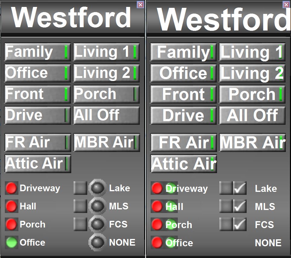

Works pretty good for me. Some of the fonts seem larger than they are when displayed by the SWRemote. Multi state indicators are showing both halves of the picture. It's missing a colum of buttons lower right. But pretty good so far.
Here is a picture with the SWRemote on the left and your rendition on the right.
And another theme:

Re: Housebot Browser Client - ALPHA CODE
That's actually pretty cool... And successful for a first time running on someone else's theme.
The indicator behaviour is normal. It's showing all the states at start-up until one is picked. This will go away as soon as I actually tie it into HB values.
The font size issue I've seen before, and I'm not quite sure what's going on because a font size is a font size.... Period. I'll add back onto the todo list to look at.
What's the type of buttons are missing? Multi-state buttons? Plain buttons? or ????

Tim,Timoh wrote:What's the type of buttons are missing? Multi-state buttons? Plain buttons? or ????
They are "execute task buttons". They start a task which sends the right sequence to my modem to forward or unforward my phone.
The fonts may not be a standard size picked from the selection offered. I may have just entered a size I thought would fill the button best. For instance in the larger theme the WESTFORD at the top is set to Arial size 108 weight 700 and most buttons are set to Arial size 60 weight 700. Perhaps the browser doesn't scale them quite the same when they are not a default size.
