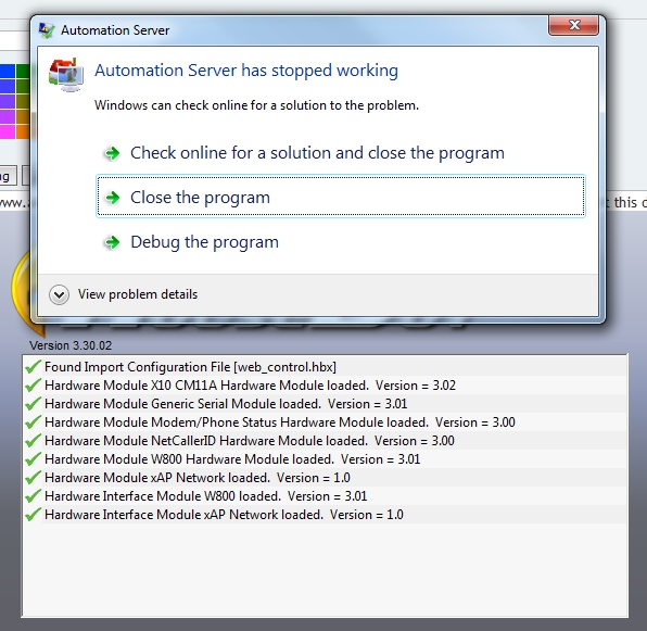

9. It is now at this point I think we need to add xAP as a hardware interface. So now we should be able to go to "Hardware Interfaces", "Add Interface", select "xAP Network", give it a name ie "xAP Network", press Next etc BUT this is where Housebot completely crashes on me :(
Attempting to restart HB brings me to the point in the attached image. Unfortunately, there is nothing in the dump folder.
The hardware module and basic config has been added to the DB but no Network, Source Address, UID has been created. Manually putting values does not work either. It still won't start. Good thing you made a backup of the database :wink:

Point at which HB crashes after adding xAP hardware device
HB Crash.jpg (208.9 KiB) Viewed 4517 times
