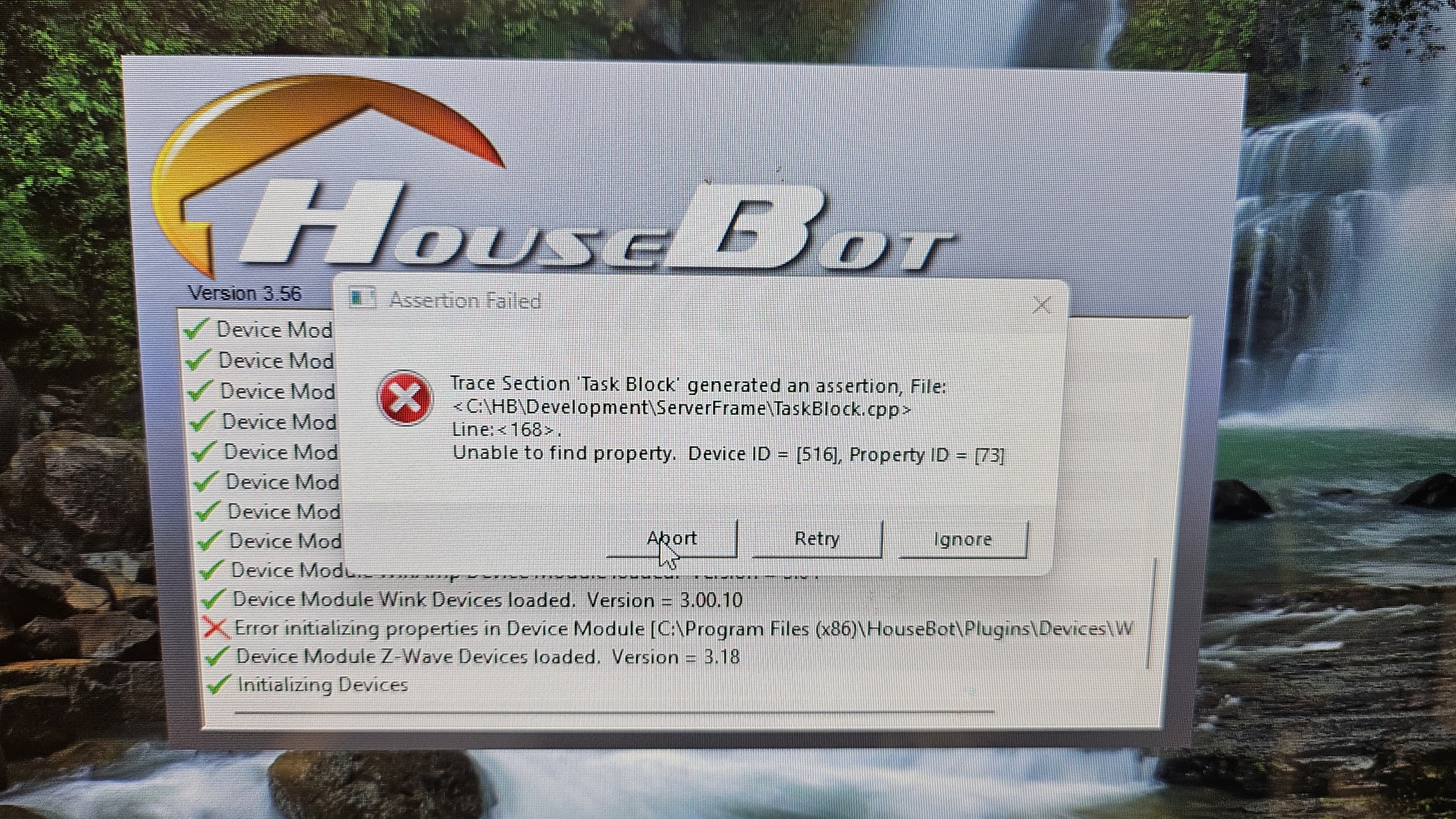

(Just now getting back to this.) Short explanation: HB server launches with the generic CONFIG folder and using the Run as Admin tip from above. But obviously its an empty vessel. When I copy/replace the CONFIG with mine I get this ugly message. See attached pix. Since I have no way of knowing which device it’s referring to - since HB won’t run on the old WIN10 box - I am once more clueless. I did try RETRY and Ignore and it still does nothing.
- 20241228_143257_Original.jpeg (4.3 MiB) Viewed 135254 times
Re: housebot crash and reinstall failure
Steve,
You can either open the HBData.db sqllite database file and try and fix it, or you can send it over to me and I'll look into it.
OK, I can look inside HBData.(I havent been here in a LONG time.) DevID is a TIVO STB. Prop 73 is Send IR command. Delete the device??
