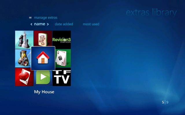

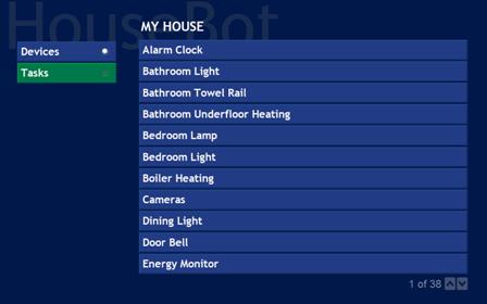

I have finally done a few updates to my mce plugin. Nothing major, just a few minor annoyances.
Updates are:

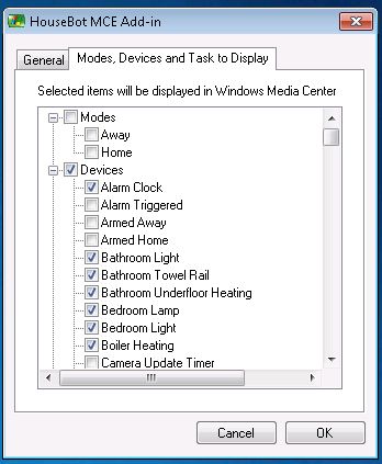

- Config application now allows you to select what devices/tasks/modes to display in Media Center.
- Fixed some layout issues, scales correctly on 1080p.
- Back button works correctly now.
When you install you must have HBControlMod.HBControl installed, this can be done with regsvr32 or installing Housebot. More information in this thread. I'm using it on Windows 7 Media Center.
