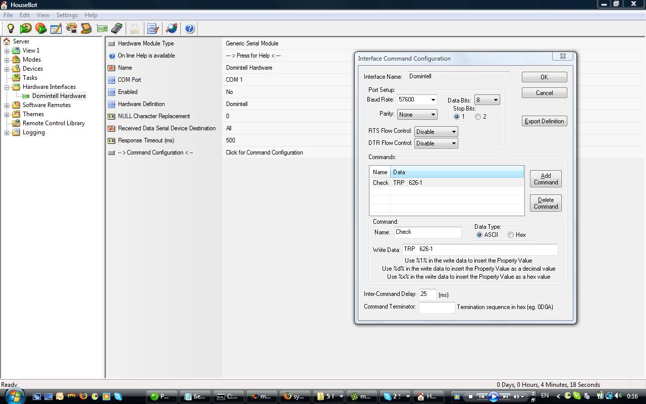

.jpg
.jpg (122.34 KiB) Viewed 55624 times
Maybe I need to set up something in the window? Also I would like to read more about each option.

There is a detailed description from this, titled as "Configuring the Generic Serial Plugin" in tutorials section of this portal.
Laszlo Menesi
Re: Send message by COM port
beginner wrote:...Also I would like to read more about each option.
The online help should provide the detail for all of the options.
And as menesi stated, there is a new tutorial for how to configure the generic serial plugins that you may find helpful.
