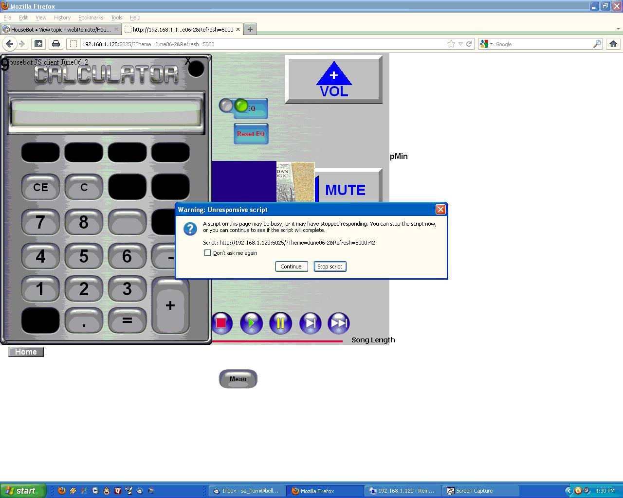

Re: webRemote/Housebot WebServer - March Release
It "works" as you describe - the theme eventually loads but the result is not pretty: lots of left over images scattered about (out side of the panel area). But the home panel seems to all be there. Unfortunately, this panel has a dynamic image (weather radar) that is overlaying much of the buttons. So the transparency issue is still an issue. But the time-of-day is being updated. Of course, none of the buttons work but I didn't expect them to. Should they? At this point I'm not sure I know what should be functional and what is on the punch list.
- HBWS0312.JPG (149.87 KiB) Viewed 44939 times

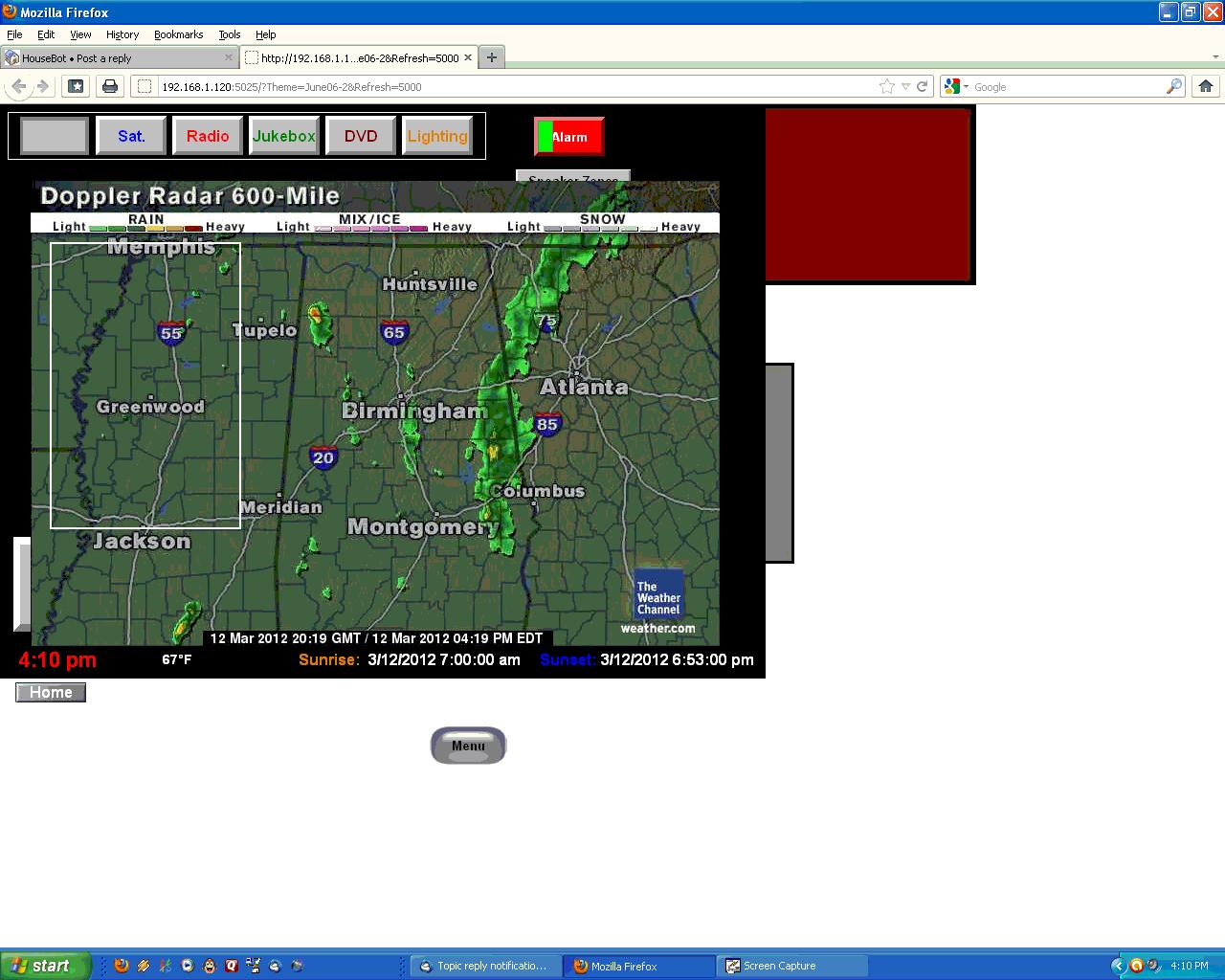

In addition,
1) during the load I got 1 or more of these:
2) and several other themes I tried - as simple as one panel in one case - did not load at all. Go figure...
- HBWS312A.JPG (136.42 KiB) Viewed 44939 times
