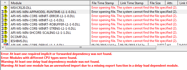

Re: Wrapper for C# plugin development!
Ran that dependency walker program against HbDotNetBridge.dll and got this. I have no clue what this means. But did a search for the first one and only found a similarly named file. Any help is appreciated!
- dependency errors
- hbdotnetbridge_dll_errors.png (27.41 KiB) Viewed 84980 times

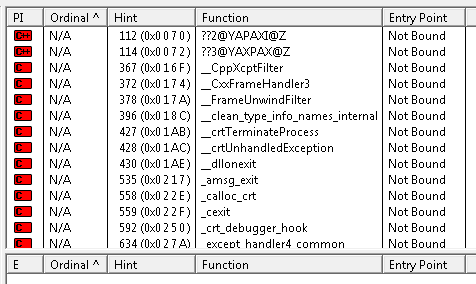

Hi Steve,
I am working on getting the C# wrapper working. I have it working on one laptop (my test laptop) but it is not working on my 'production' laptop.
Interestingly, I get the same error as you are gettting on my 'production laptop' right now:
I ran the DLL walker program that Scott linked above and I get only one difference: The Test laptop does not show any problems with the MSCVCR120.DLL wheras the Production Laptop Does (and I notice you have issues there as well). This is part of what I am seeing on the Dependency Walker Program:
I will do some googling around to see if i can figure out what is going on. I am not at all an adept programmer though...so it may be a very long shot.
The Production Laptop that is not working shows :
I hope this helps in figuring this out! :)
