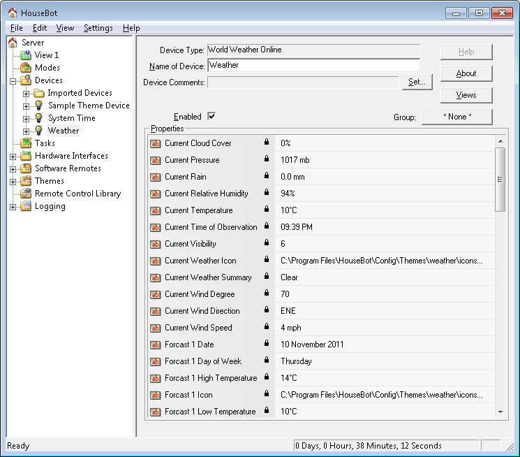

Hi All,
I'm the developer of the c# weather.com plugin. I have just built a new one using the api from worldweatheronline.com. It will display current weather conditions and the next 5 days.
You will need to get a license key, it's free from http://www.worldweatheronline.com/register.aspx
Source code and dll can be found on codeplex: http://worldweatheronlinehb.codeplex.com/
It's only just been created and tested on my machine for the last few hours. Seems OK, but an early beta. If you get any issues let me know. You might want to run it on a test pc first.
Cheers Al

Updated to version 1.0.2, let me know how you get on.
