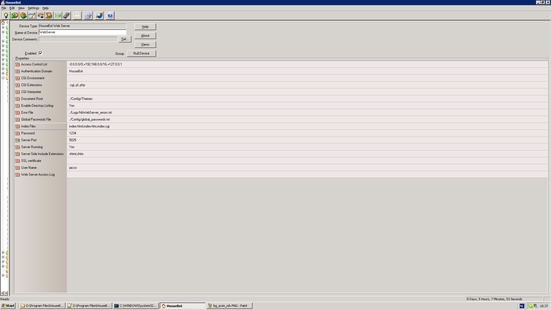

I am using Google Chrome, perhaps it is something in the settings, can you look at the attacement?
- webserver.PNG (105.64 KiB) Viewed 45946 times
Re: HouseBot Web Server
looks the same as mine except for 'User Name' and 'Password'.
