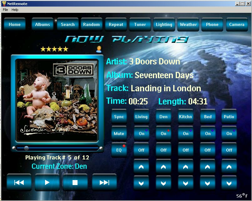

5) I like to create my own look and feel. My 'Now Playing' Netremote skin is one example. Does Meedio allow the user to create their own skin and allow buttons to send IR and X10 commands or even play macro's?
6) I see that HB supports Girder. Will HB receive girder payloads and fire of events from them?
Here is a sample of my interface screen.

Yes, the UI on the SWRemotes is 100% skinnable. You can use your own graphics or choose from some of the stock images. Pressing buttons on the SWRemote will change Device Properties back at the server (or execute Tasks, Modes, etc). Once you play with HB a bit and get a better understanding of how the Devices and Properties work, you'll see that they are the common backbone of the system and can be leveraged in many different ways.5) I like to create my own look and feel. My 'Now Playing' Netremote skin is one example. Does Meedio allow the user to create their own skin and allow buttons to send IR and X10 commands or even play macro's?
