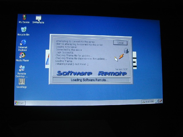

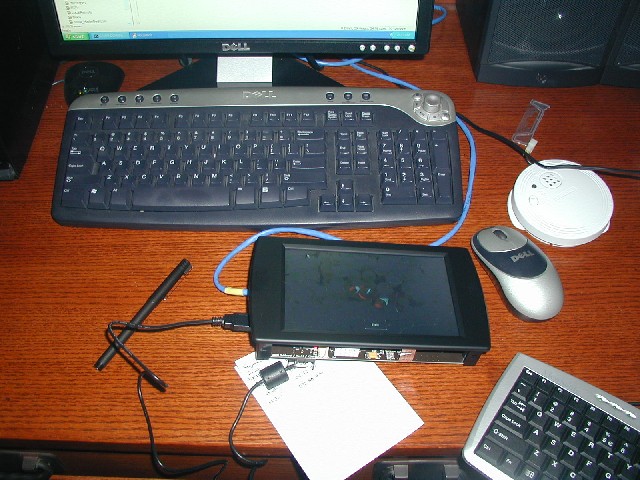

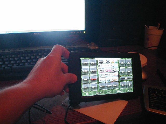

I purchased one for some testing and it runs the HouseBot CE 5.0 swremote without issue. You just have to be diligent with your images as memory can become a problem when using multiple images or button types to build a theme for the device. It also has an rdp client built in. The only issue is the bar at the top of the screen when a rdp session is active (see pictures). The resolution on this thing is great and it has the potential for in-wall mounting with the right enclosure. Hope this is of use.
Images running the native CE 5.0 swremote:
- cuwin_size.JPG (104.7 KiB) Viewed 17331 times
- ce_swremote.JPG (51.93 KiB) Viewed 17329 times
- ce_swremote2.JPG (94.95 KiB) Viewed 17330 times

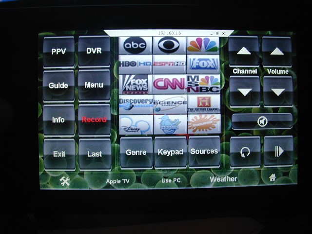

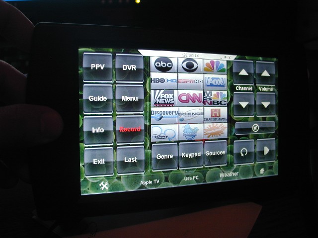

Images using the rdp client:
- rdp_swremote.JPG (60.41 KiB) Viewed 17320 times
- rdp_swremote2.JPG (54.79 KiB) Viewed 17317 times
- rdp_swremote3.JPG (71.6 KiB) Viewed 17319 times

I was just demonstrating that you have both options available with this thing.
Ideally, I'd like to use the CE swremote. The biggest issue is that CE doesn't support transparency (and oh how I love transparency). I will have to play with it some more to see how far I can push it with multiple images/buttons etc. before it shuts the little guy down. I tried to load my nokia theme on it and it died (lots of images/buttons in the theme, multiple panels). However, I haven't thrown the 1 gig SD card into the mix yet nor optimized memory available for applications.
If you have a massive theme and really want transparency, you will need to use rdp. The issue with this is the number of concurrent sessions in XP (I can only get 3 to run in a stable fashion). I will look into hiding the little rdp bar at the top of the screen.

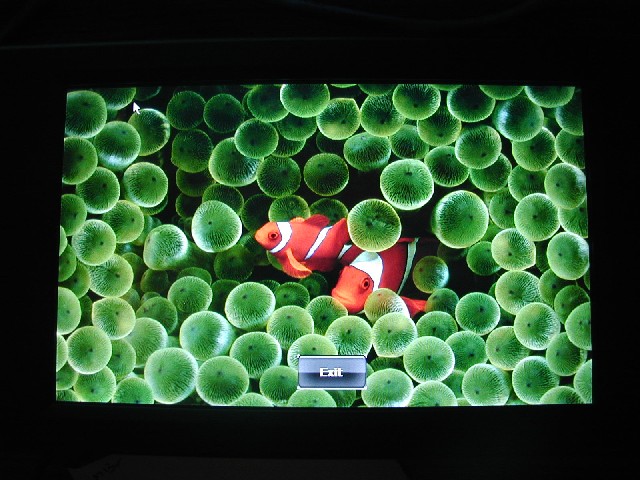

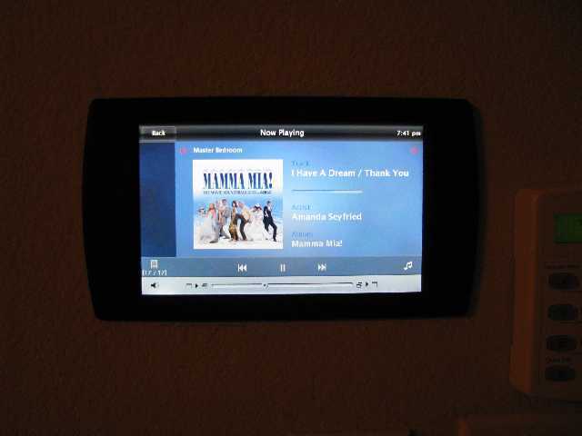

Ok...finally got this up and running. I rewrote the .exe so that you have a screen to fall back to if the connection is lost with a big "CONNECT" button to reinitiate the RDP connection. I also got power-over-ethernet to work with this thing. It is a maximum of 12 watts per specs, so it falls well within the POE protocol for power delivery. So, in a nutshell, it is mounted in the wall with a single Cat-5e cable providing data and power support
New AutoRun.exe, AutoRun.rdp, and AutoRun.txt files included. Once configured and installed to the SD Card, change the dip switches to have it boot to AutoRun.exe on power up and you are off to the races.
EDIT: I must apologize for all of the Mama Mia album shots in my themes. My kids seem to love Abba and I don't really know what to do about it.

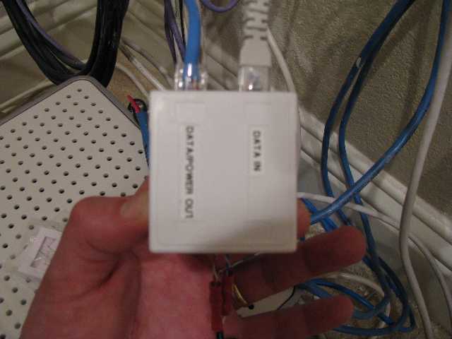

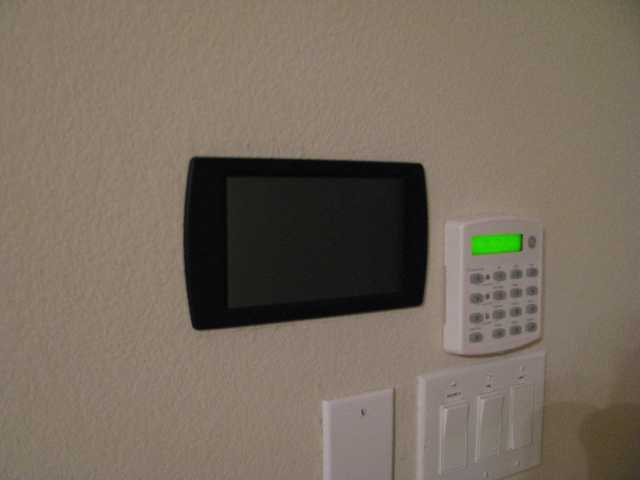

Some pics of the POE injector. It is a 2 jack, surface-mount Cat-5e connector. Brown/Brown-White and Blue/Blue-White are brought out to connect to the power supply. There is another one of these in the wall with the touchscreen to split power away from the data line.
