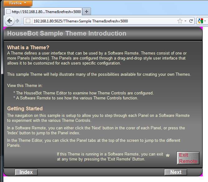

I see the directory listing OK using IE8 but with http://192.168.0.3:5025/?Theme=XGA&Refresh=5000 I only see 4 random characters in the top left corner changing whenever the F5 Refresh button is pressed. So no display at all.
A logfile first said it was missing favicon.ico and after deleting it, a new one didn't get written.
After setting the device, most of the properties were blank. I copied the values from the help file.

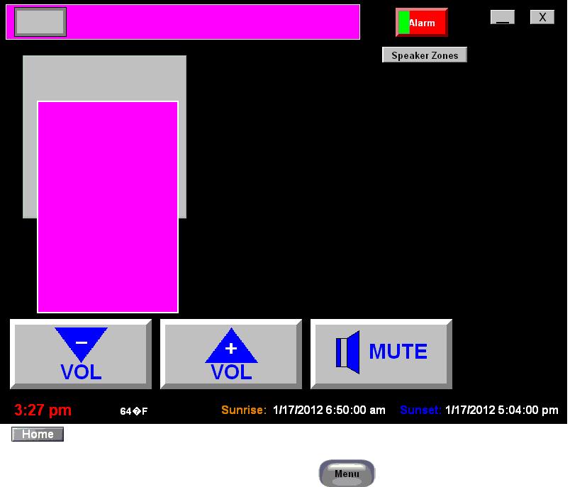

The sample theme is working, but my own theme not. Here are the screenshot's
My theme / below the remote screenshot of this theme Remote screenshot

Richard, Your issues are probably due to IE8. There are no browser checks at all in the code, so mileage at this point will vary against browsers other than Firefox. I'll check out why the default values didn't show up... Strange because I know they're set in the plugin.
Jacco, It looks like I have some javascript that doesn't like your theme. What you see is typical when the javascript has failed 1/2 way through drawing the theme. You should be able to see the offending error message and javascript line in your error console for firefox.

Richard, I have reproduced your issue... It seems to have something to do with renaming the dll. Which I did right before I uploaded it.
Jacco, you might want to double check you plugins folder as well... It should only have 1 dll called hbwebserver.dll. If there is dll called hbwebserver0116.dll, delete it and also the hbwebserver.dll and drop in the new one from the zip.

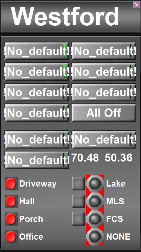

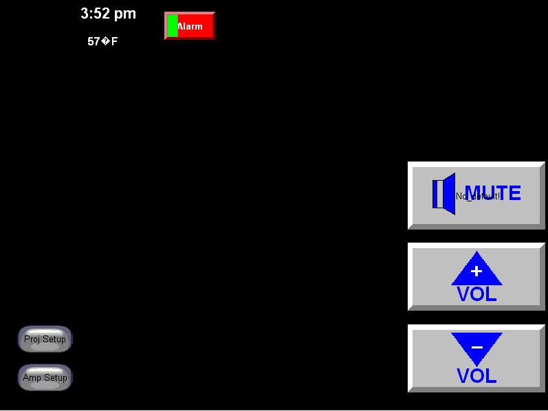

Great progress! My Themes are displaying pretty well now. They are pretty simple so I'm sure some of the fancy ones I've seen might still have issues.
A few remaining issues:
The multi-state buttons are not displaying the text. They all display "!No-default!".
Text I have as center justified is diplaying left justified.
Transparent parts of buttons display red ( I know this is on the next up list already)
I attached a picture of the theme I've attached before to show proof of the progress.

Mark, !No_Default! can appear as a result of two possibilities...
1- when there is no default state specified on the multi-state button and the webremote has not yet received an update from the server.
or
2 - when there is no default state specified on the multi-state button and the webremote has received a value that does not correspond to state value in the webremote.
Had a refresh happened? Do the indicators make sense? It's also possible that the panel was drawn and then the client crashed and never pulled a value.
or

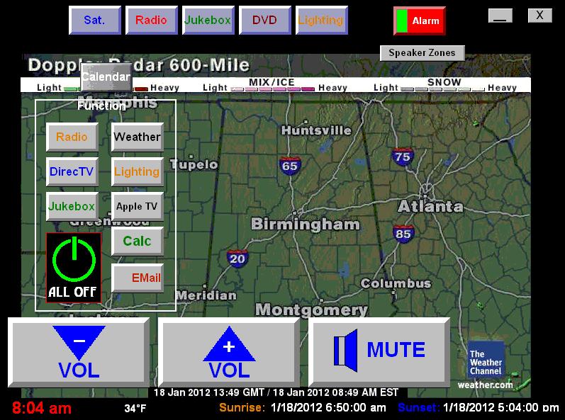

Here is what I get when I pull my main theme:
I tried to pull simpler, less busy themes but they would not display at all. Tried another - basic buttons. Got this: Here is the SWremote rendering: For the themes not displayed, I tried to capture the error log entries, but the file was not being written. I had seen it before but had deleted it to get a fresh listing of errors. got none.
I could not access the help file. I suspect that IE is not configured to access help over the net. Need to look into that here...
FWIW
The pink areas are background static images - basically boxes. The large gray box is a dynamic image - weather radar. I need to look at the XML file to see if the outlier 'Menu' and 'Home' buttons are orphaned and no longer applicable - that may be an issue on my end.I tried to pull simpler, less busy themes but they would not display at all. Tried another - basic buttons. Got this: Here is the SWremote rendering: For the themes not displayed, I tried to capture the error log entries, but the file was not being written. I had seen it before but had deleted it to get a fresh listing of errors. got none.
FWIW

Thanks Steve. I was wondering what it looked like.
I suspect the buttons are getting drawn, but they are behind the pink boxes since I have not done transparencies yet. So not as bad as I thought. Possibly a similar issue on "basic buttons", but they're behind something.
I am perplexed though on the dynamic image as a grey box. It looks like it's not getting updated. And I assume that your default image in the theme is the grey box. In fact, I think it's the same issue JMan had, which I did not understand.
What is the property value of the dynamic image? How often does it change? Where is the file stored/path? (Same questions for you Jman if your following.)
Now I know... And knowing is 1/2 the battle.

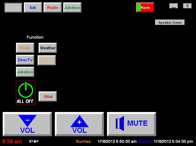

I took one of the simpler themes, deleted the background boxes (the pink transparencies), and loaded it:
The grey dynamic image box displays a radar image that is refreshed every few minutes, although the actual/source NOAA image is not updated more often than 15 mins. Regardless, the image is grabbed and the file saved as a jpg: c:\Program Files\HouseBot\Config\Themes\Common\weather\us_bhm_closeradar_large_usen.jpg
The upper left gray box has transparency and color adjustment properties, so what we're seeing is explainable. With the exception of the 'degree' sign (lower left, displayed as a diamond '?'), all else is as it should be. Dunno why it says 57 degrees; its really 37 but that is not a webserver issue.)The grey dynamic image box displays a radar image that is refreshed every few minutes, although the actual/source NOAA image is not updated more often than 15 mins. Regardless, the image is grabbed and the file saved as a jpg: c:\Program Files\HouseBot\Config\Themes\Common\weather\us_bhm_closeradar_large_usen.jpg
Re: webRemote/Housebot WebServer - January Release
Ahhh... The webserver will not recognize c:\program files\........ etc
I believe the HB recommened way is to use %%HB_Themes%%, which I strip out on the server so the browser gets the right path to the image. Since I suspect many folks are using the entire path, I will add in to some processing that make the path property value web server/browser friendly.
