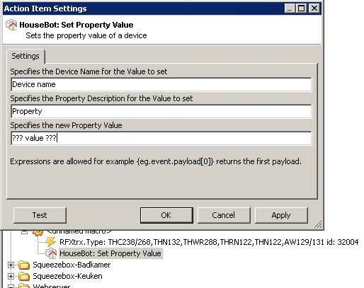

I received an temperature from an Oregon sensor, but how do you write the value to the property value?
Maybe stupid question, but I have no idea how to do this.

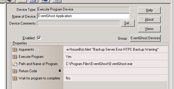

Yes as Kevin said. The plugin is only one way (EG->HB). But can use the EventGhost.exe commandline via the Execute Program Device, see screenshot.

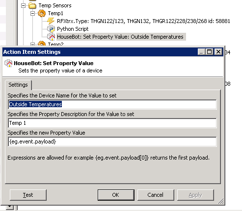

Regarding the value, its not a stupid question. You need to pass the payload. It took me a while to get my head round it. But there are plenty of posts about it over on the EventGhost forum. I also use the Oregon sensors, you can set the value as {eg.event.payload}. I also run a script before that removed all the junk. See screenshot and script.

pay = eg.event.payload.split(" ");
eg.event.payload = pay[2].replace("+","");
print "Temp is " + eg.event.payload;
