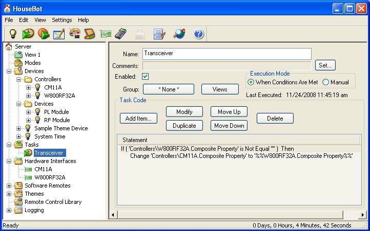

kilowatt
Posts: 152
Joined: Thu Jan 08, 2004 5:45 pm
Location: Westford, MA
Re: X10 Transceiver Device
Post by kilowatt »
With the task shown I could not perceive a difference in delay between using the task shown below and having housebot relay the command. I tested using housebot version 3.01.
