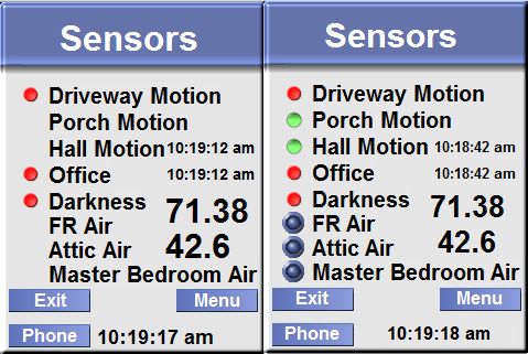

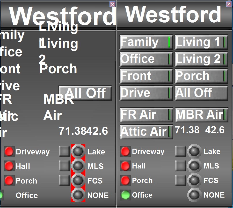

It looks like your getting the device status pretty well now. I attached two themes. On the right is SWremote display and on the left is your rendition. I see issue with the display of some items but overall it's coming along well. One problem is with indicators. When the state is such that the display is showing image 2 what you display is marching to the left with each update. In the larger of my attached themes you can see one near the lower left has moved left after the first update. In the smaller theme two indicators have already moved off the screen. Multistate buttons don't seem to display so these are missing on the pictures below. Some text items in my theme are center justified and these are left justified in your rendition. There is also something funny happening with some of the time properties displayed (next to Hall Motion in the second picture) this updates on each refresh but is not changing in the swremote display. I'll look into if the value is updating in housebot and let you know what I find. Mostly minor issues I would say. Congratulations on your progress. I'm looking forward to using this with my android phone.

The strange time property thing is a housebot bug and not something your doing. If I check the value of these times in the housebot server program they seem to change each time I look at the property even though the task that updates them has not run again. The value only update when I look at them (click to display some other property and then go back and look at that one). The history (tab) shows the new value was set because the task updated it but the time than task ran is still the same as the last time I looked and only the new value has changed. Anyway your refresh causes the value to change but the bug is not yours.

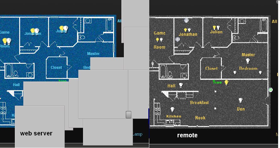

Great Job! Looking forward to this in full functionality. What are the limitations as far as what images will display on the panels? It appears that none of my static .bmp files display.

JMan, Any image which can be displayed in your browser should work. Therefore .bmps should be ok. Can you be more specific in what's not displaying. You have an image property that specifies a static file or you've dropped an image directly into the theme? or?

I have several .bmp's that are images of lights with a button behind them and the "click through transparency" on. I saw an earlier post that said something about transparency not working but the images are not loading correctly. Included is a view of my remote and a view of the remote in the web browser plugin, the xml view is too big to post. Let me know what you think. I may just have to simplify my remote. Overall though, great progress.
webserver on left, remote on right
the .bmp files show up as big grey squares and they should be all the light bulb images you see on the right

Can you reproduce in a very simple theme and send me the xml? I suspect it has something to do with the transparencies, but I don't know why the grey boxes would be so big... I would have thought they would be the size of your button or underlying image.
+ I am assuming that the dependencies are loading properly? Webremote would halt and timeout after 30s if not.

What type of buttons are on your big grey display. Multi-state?
kilowatt
Posts: 152
Joined: Thu Jan 08, 2004 5:45 pm
Location: Westford, MA
Re: HouseBot Web Server
Post by kilowatt »
Yes, They are Multi-State buttons. The font is set at size 60 which seems to display slightly larger on the web page than in the software remote. The three missing ones on the smaller theme are also Multi-State.
