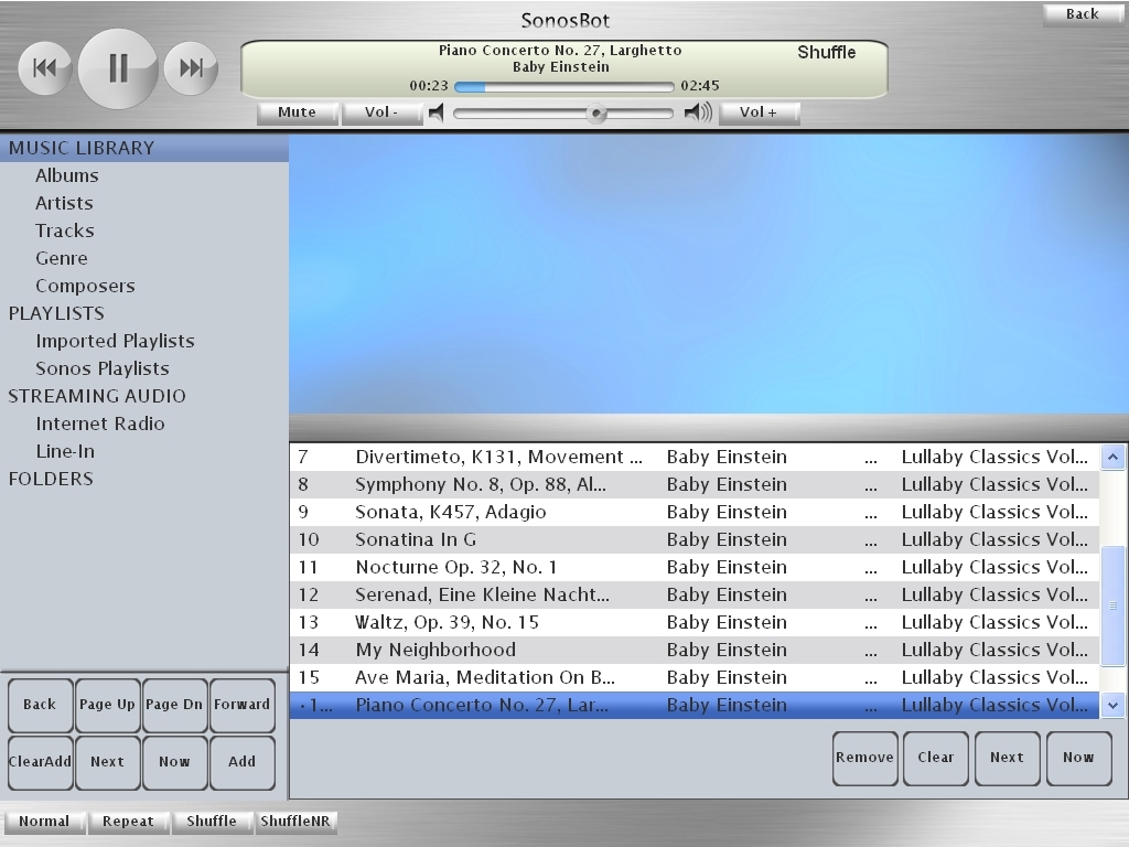

Screenshots

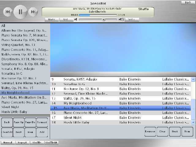

Screenshot of panel with media library that is browseable in the left pane. The first row of buttons at the bottom of the pane allow you to move through the library. The second row of buttons allow you to add tracks to the queue in 1 of 4 ways: 1) Add - add to the end of the queue; 2) Now - add it to the queue and play it now; 3) Next - add it to the queue such that it is positioned within the queue to play next 4) ClearAdd - clear the queue and then add the selected track.
The buttons beneath the queue (right pane) allow you to manipulate songs within the queue. You can select a track in the queue and play it now or play it next. You can remove a track from the queue. You can clear the queue. The currently playing song is highlighted in the queue with the select bar. In addition, the track number of the currently playing song is prefixed with a "dot" as well.
Second shot shows the menu pane drilled down to track level (using Genre -> Childrens Music -> Baby Einstein in this case).
Most recent script, wsc, and .hbx will be uploaded upon request.
- Sonos_Screenshot_MainMenu.jpg (34.12 KiB) Viewed 144595 times
- Sonos_Screenshot_Drilled.jpg (42.64 KiB) Viewed 144594 times

Ok - I've been playing a little now and I have three zones of Sonos setup within HouseBot. It all seems to work really nicely . Except I left it running overnight last night and this morning HouseBot had crashed and was showing 140MB of memory usage . So I started it up again this morning and left it and the memory usage is slowly rising from around 20MB to 40MB once I use remotes and now at 70MB. Some purging does occur to reduce this but the trend is upwards. Is it possible that there are memory issues either with the script invocation mechanism or the code itself ?
I have three scripts running and I have setup a 'repeat all' loop on my tracks, different in each zone, to get constant updates and I'll see what state we're in tomorrow. BTW These devices are the only ones I have in HB currently.
Just as an aside. Now we have 'on demand' feature in v2.5 for people outside the US with Napster (great job Sonos) it would be such a nice feature to have a script ability to recover artist/album info from Napsters DB - and to play a song 'on demand' by supplying artist, album / trackname. A 1 million track JukeBox...
Pretty sure however that Sonos will have made this very difficult (non UPnP) although their Desktop Controller can do it.

Kevin:
Thanks for testing this out. I have yet to add my other two zones into the mix, as I am still debugging little-by-little. I have had the continuously running script up for days at a time on one zone without any issues (other than a power outage and my router going on the fritz....which I really hope aren't related to my code). I am in the process of optimizing the code at this point. Please find attached a new .hbx import. This has the latest script (optimized, with the new features depicted in the screenshots above for additions to queue and queue management) as well as the latest ZonePlayer.wsc file to replace the current one (simply copy it to where the current one is, no need to re-register). This new script fixes some issues with the queue updated twice in some instances, creating a flicker effect on the screen as well.
If you are interested in adding Napster, Rhapsody, etc. then I need to enlist your help as I don't use these services. If you are interested in providing me with some info, then download the Intel UPnP Tools (or let me know and I can post the necessary tools).
My next step is adding album art to the mix. The album art files can be downloaded from the ZonePlayer....I just haven't quite figured out how to do it yet.
Suggestions on interface layout would also be appreciated.

Double click to drill can be done...you just need to change the double click property of the list control to perform the property substitution accomplished by the select button I have at the bottom of the left panel. Open the theme and click on the left pane list control. In the double click property change, make it match the property change for the select button. You will still need to use back, pg down, and pg up, though (pg up and down are due to limitations on the size of a list that can be imported into HB...though this may not be an issue for you). I have it set up this way because I use it with a touchscreen and double click is a bit tricky with fingers. Also, you can change the number of items displayed at a time by opening the script and scrolling down to the BrowseMedia sub (last sub, methinks). The item to change is commented...currently set to 14 I believe. Scrollbar will appear automatically if the list size exceeds the display area. If you set this value to "0" then all items will be returned...if HB croaks when you do this, you have exceeded the list size limit (recently increased by Scott so it may work for you) and will need to use page up and down.
You can use the existing device, just make sure you check the beggining of the script to make sure your current device has all of the properties the script is expecting. If not, create the property and add it to the device then point it to the new script.
Yes, there are some issues with the queue display that need to be fixed for cosmetic reasons. I am in the process of doing this currently. I can't bold a particular item in the list...but I could make it all caps or add the carat as you suggested.
