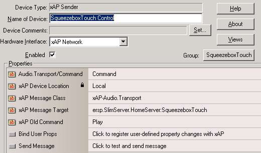

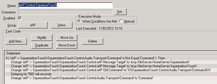

To control the SqueezeboxTouch I use the Xap Sender and an task to control it
Xap Sender.jpg (26.22 KiB) Viewed 24036 times
Xap Sender Task.jpg (38.78 KiB) Viewed 24036 times

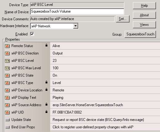

For the level control I use xAp BSC Level
To adjust the volume I run an script to change the level + or -
Xap Sender Level.jpg (37.57 KiB) Viewed 24036 times

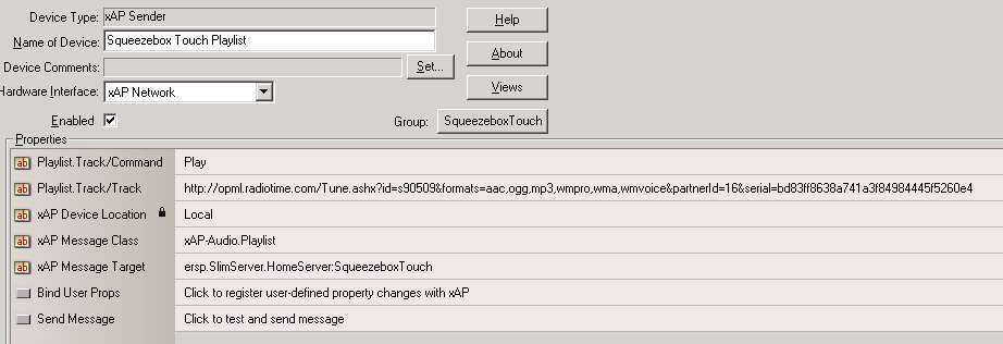

Start an Playlist
Xap Playlist.jpg (39.54 KiB) Viewed 24036 times
