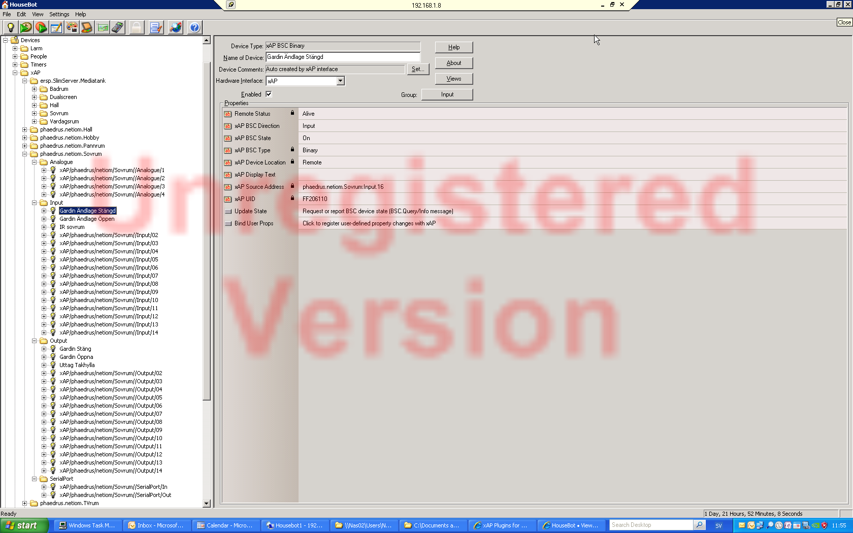

I want to know more about the xAP Netiom, can you tell more about this hardware, maybe a screenshot of HB?

its a old but good HW... 16 in, 16 out, 4 analog in and serial, small webserver ( i do not use) config thru serial port (not web). lots of extra devices on each pin ( counters etc.. (16bits)) easy to disable not used devices by enter space in name... HB xAP plug autogenerates all devices in devicelist, xAP plug can set custome states like open/closed or UP/Dwn...
really nice to put a couple around the house and you will have available I/Os close... i use for door switches,IR sensors, heating etc... works like a clockwork...
(only noticed one problem and that is when i run IP-tv on same network it sends crappy xAP mess... extremley seldom and have disapeared after segmenting the network with separate cables for IP-TV... will see if it comes back when i install IP-Cameras around the house...)

- ScreenShot003.png (373.5 KiB) Viewed 6792 times
